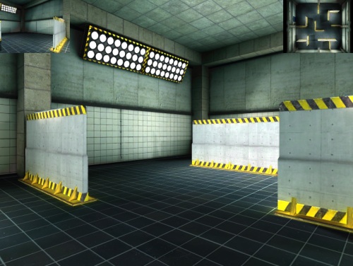

Now we will add another subwindow and viewpoint which will show a rear view of the scene. The code is similar to creating the birds-eye-view:
RearWindow = viz.addWindow()
RearWindow.fov(60)
RearView = viz.addView()
RearWindow.setView(RearView)
If you run the script you will notice that the new subwindow is on top of the birds-eye-view window. The following code will move the new subwindow to the upper-left corner of the screen:
RearWindow.setPosition([0,1])
This tells vizard that the subwindows upper left corner should be placed at screen coordinates (0,1). Remember that screen coordinates range from 0 to 1 where (0,0) is the bottom-left corner of the screen and (1,1) is the upper-right corner of the screen.
Now we need to have the rear view point behind the main view. To do this we need to create a link between the MainView and the RearView.
#Make RearView look behind MainView
viewLink = viz.link( viz.MainView, RearView )
viewLink.preEuler([180, 0, 0]) #spin view backwards
Now run your script and the rear view should always be pointing behind the main view.
