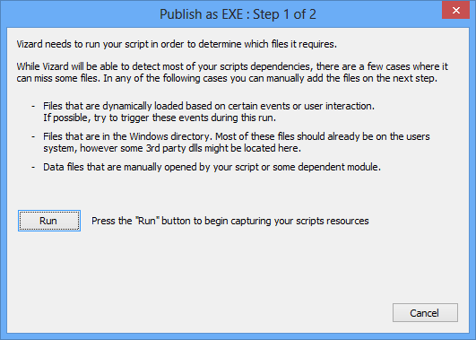

Save the script and then select File > Publish as EXE to launch the publish wizard:
Press the Run button to start capturing script resources. In order for a resource to be automatically detected and added to the list of dependencies, it needs to be loaded by the running script at this time.

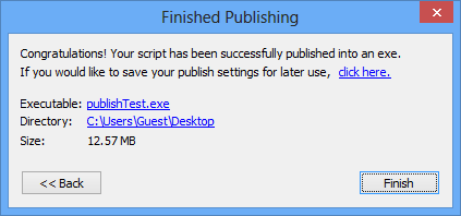

In the next section you'll get a chance to enable the display console. For now, leave both options unchecked. Click Publish and wait for the Finished Publishing dialog to display:
