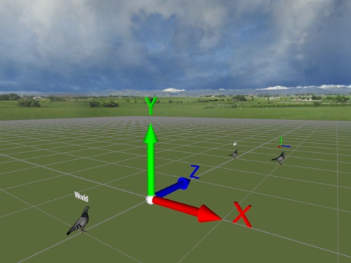

Now we add two smaller pigeons we will move about using different coordinate systems.  To distinguish between them, we'll give them some labels:
childPigeon = viz.addAvatar('pigeon.cfg', scale=[0.8,0.8,0.8])
childText = viz.addText3D('Child',pos=[0,0.4,0],scale=[0.1,0.1,0.1],parent=childPigeon,align=viz.ALIGN_CENTER_BASE)
worldPigeon = viz.addAvatar('pigeon.cfg', scale=[0.8,0.8,0.8])
worldText = viz.addText3D('World',pos=[0,0.4,0],scale=[0.1,0.1,0.1],parent=worldPigeon,align=viz.ALIGN_CENTER_BASE)
The setPosition method changes the transformation matrix associated with a node. We now modify the transformation matrices of both pigeons so that they move back 1 meter on their parent's z axis.  If the pigeons had the same parents, they would be overlapping each other, but we set the parent of childPigeon to mamaPigeon. This moves childPigeon 1 meter behind mamaPigeon. The worldPigeon however is anchored in the world's coordinate system and is positioned 1 meter behind the world origin. Their positions in the world are different because the positions of their parents are different:
childPigeon.setPosition([0,0,-1])
worldPigeon.setPosition([0,0,-1])
childPigeon.setParent(mamaPigeon)
Run the script to see where each pigeon is located.
Hit the spacebar to again animate mamaPigeon walking. You'll see that childPigeon also moves, staying a constant 1 meter behind her. The child's actions looks a bit unnatural, especially when the mother rotates, but this demonstrates how a parent's movements will affect it's children.
